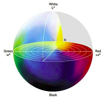

Therefore, a kind of color language is necessary to describe the spectral components of a certain color, which is not discussable by people (as for example sky-blue, deep blue, ocean blue or pale blue would be). A language that describes all the colors visible for humans, with the words of a computer, needed to be created.
This language is called Lab, where L stands for lightness and a and b for the color components. With Lab it is possible to describe a color very exactly. We are going to have a closer look on Lab later.

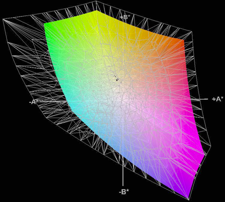

color SpaceEach type of camera has its own way of seeing colors, such as each type of monitor has its own way of displaying colors. Also, printers have their own range of printable colors, which varies from type, ink and paper. This range of colors is called color space. A color space describes all colors that can be processed by an imaging device.
The most common color space is sRGB. It describes the average color space a standard monitor is able to display. Most digital cameras are able to capture in sRGB color space and most printers can also print out images correctly in sRGB. Still, there are bigger color spaces such as ProPhoto RGB, Adobe RGB 1998, Wide Gamut RGB.
These color spaces are used when highest quality is needed. Still, for most purposes sRGB is the right choice.
Image 1: Comparison between sRGB (inside, colored) and Adobe RGB (outside, wire-frame)

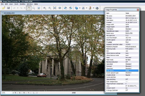

Sony's Alpha cameras can shoot either in sRGB or Adobe RGB mode. If you have set your camera to capture in Adobe RGB, it's clearly visible on the camera's monitor. Besides, images shot in Adobe RGB can be recognized by a _ at the beginning of the filename (example: image1234.jpg → sRGB; _image1234.jpg → AdobeRGB) If you are still unsure which color space you have chosen when taking the image, you can consult the EXIF information.

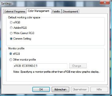

You need to set only a few options for achieving a fine color management workflow. Please choose settings in menu and open the color management dialogue. You can choose the working color space in the upper part: If you choose sRGB, Adobe RGB or Wide Gamut RGB, IDC SR will always publish processed images in the desired color space. If camera settings is chosen, IDC SR will take the working space is set in the camera. It can be either sRGB or Adobe RGB.
Below the working space, you can find the color settings for your monitor. The choice will strongly influence the appearance of images in IDC SR, so you should keep an eye on it and - from time to time - check if the settings are still ok. If you do not have a certain monitor profile installed on your system, please choose sRGB.
In case your monitor was delivered with a generic display profile, please install this profile in your operating system and afterwards choose it in other monitor profile.
For a highly professional workflow it is necessary to calibrate the monitor (and also the printer). Individual monitor profiles that were created with third party color management solutions can also be chosen in the monitor profile section of the color management menu.
If the calibration was made correctly and the resulting profile is chosen in the menu, a very reliable color display quality in Image Data Converter can be achieved.

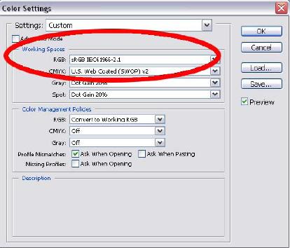

Displaying colors Correctly in Different Imaging Software
In case you like working with additional imaging software from third party manufacturers, please make sure that your color management settings in other imaging software match those set in the Image Data Converter to obtain a correct color display!
